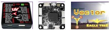

Najświeższy mailing z Eagletree
Dear RC Enthusiast,
Whether you’re into FPV racing, freestyling, or serious camshipping, the MicroVector (µV) integrated Flight Controller and OSD should be perfect for your small FPV mulitrotor or fixed wing model!
Click here for more information!
Why you need the µV:
Easy Configuration
► Fully set up and tune your µV three convenient ways:
* Windows GUI
* OSD stick menus at the field
* Optional InfoPanel LCD
Features
► Built in OSD with COLOR GRAPHICS and fully customizable screens
► Programmable video power control: Turn on/off your video camera and/or video transmitter using a radio switch, on arm/disarm, etc.
► SkyGates Virtual Racing (Experimental Augmented Reality, Optional GPS required)
► Built in Flight Data Recorder helps take out the guesswork if something goes wrong
Performance
► Fast 32 bit microcontroller
► DMA enhanced control loop running at up to 8KHz
► Advanced PID and filter tuning from either the GUI, or stick menus at the field
► Oneshot and Multishot ESC Protocols
Compatibility
► Standard 30.5mm mounting hole centers
► PWM, SPPM, Spektrum Satellite and S-BUS Receivers supported, with 4 types of RSSI
► BLHeli ESC configuration via the µV USB port
► Compatible with most PDBs, including those with built in current sensors (or use our PSU)
► Multirotor airframes: Racing Quadcopter, Standard Quadcopter, Tricopter, Y6, Hexacopter
► Fixed wing airframes: Traditional, Elevon, V-tail
Expandability
► Add our dual band GPS module for advanced GPS flight modes, RTH, and waypoints
► Antenna tracking and laptop position display available with our EagleEyes FPV Station
► Other accessories include 12V/5V PSU/Current Sensor, Alerter LED/Buzzer, Pitot tube for Airspeed, and InfoPanel LCD Display
► UART for telemetry, including ET Open Telemetry, DragonLink, and Taranis (pigtail cable included)
Eagle Tree Quality and Support
► Each µV is fully tested, and undergoes an 18 point hand calibration for best performance
► World Class Eagle Tree support via web ticket and forum discussion
ALL MICROVECTOR INFORMATION SUBJECT TO CHANGE.
